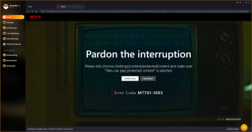

          Germania, sorry for the delay. Attached please find the StreamFab log created per your instructions. I have also included a screenshot of a Netflix error screen that sometimes happens when I click on a movie or TV series selection within the Netflix interface. However, please not that most of the time the movie or TV selection simply results in StreamFab endlessly analyzing the URL. I should also mention that, every once in a while, I am able to switch profiles and Netflix will work although most of the time Netflix will log me out of my account before the download can complete.

            paste this into streamfabs browser and retry Netflix again - https://netflix.com/clearcookies ​​
