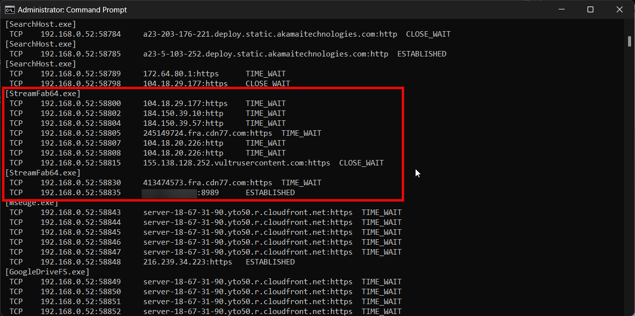

      AceDaMack:
      Open a command prompt as an Administrator and type:
      Code:
      netstat -b -f
      As soon as you press enter, open StreamFab and try to activate it.
      This should show us where it is trying to connect and which port... Then you can create an explicit firewall rule to open that port outbound

        #63
        it came back with this
