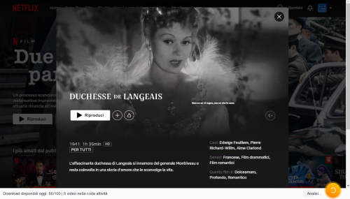

    are more than a week, that i'm fighting, with Netflix, because for the entire of the content, i'm always stuck in this step:Click image for larger version
    And nothing happens.
    I must to try more and more times for the same content, and sometimes, I can catch video and audio menu, where I can choose the quality, audio etc.
    Why?
    How can I fix it?
    Someone have also this issue?
    I must to send a feedback by StreamFab?
    Thanks in advance and for reading my frustrate

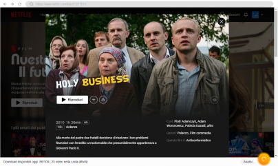

            For now, are maybe 20mins that is stuck like this:
            Click image for larger version  Name:	image.png Views:	0 Size:	141.5 KB ID:	465028
            Can I close Streamfab and post .log file ? Or I must to wait ?​

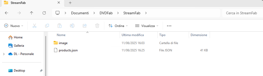

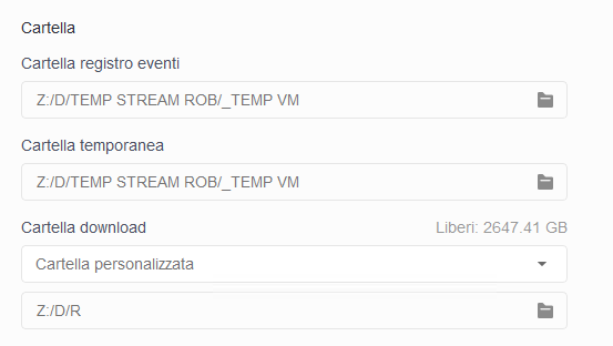

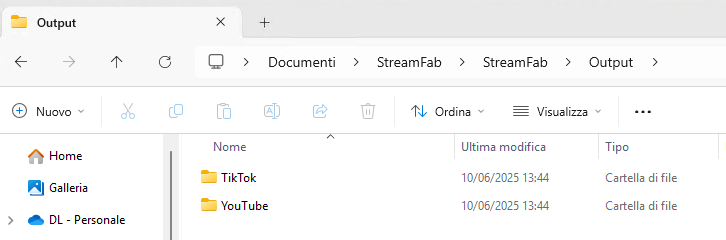

                    Sorry about the language:
                    Anyway event and temp folder, are in Z:/D/TEMP STREAM ROB/_TEMP VM
                    Here there isn't any StreamFab files.

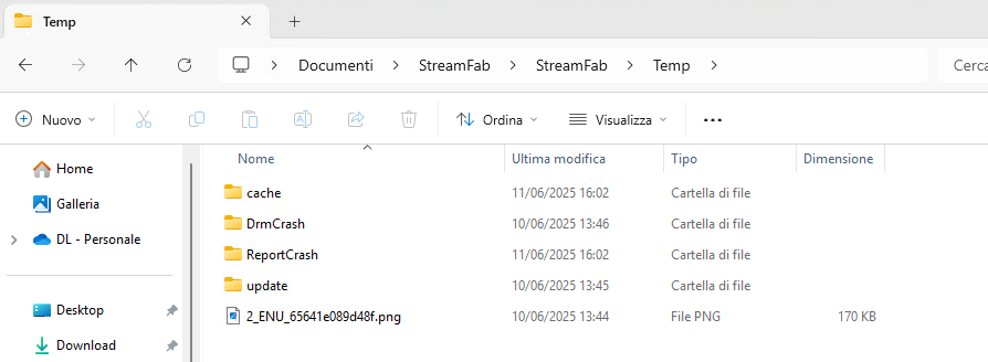

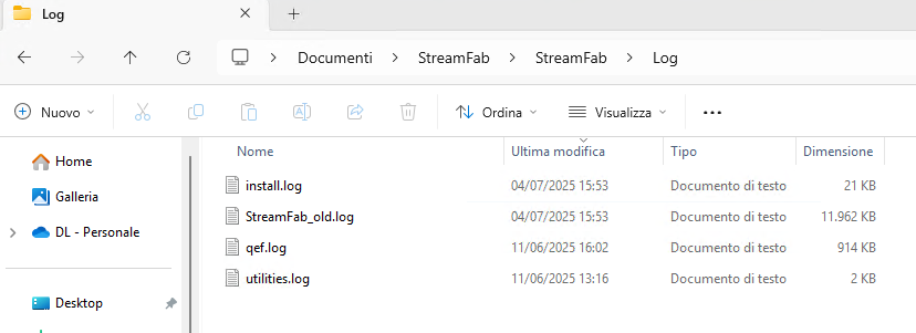

                    Here I have these files:
                    So here there is the cache.

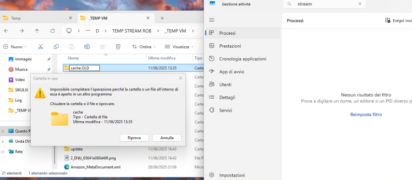

                    But I have also here the cache:
                    And this is the cache, but as you can see, I can't rename cache folder, and SF is already closed, as you can see also from task manager.
                    I don't understand
                      I don't understand
                      The language is not the problem ..
                      .. but I can't see the drive letter in your pics
                      I've never said that your cache is in "Documenti\DVDFab\StreamFab"
                      this is only the SF default - but it is not normal that is blocked when SF is closed (some seconds)
                      - so I think your VM is blocking something and I don't know why there are two different temp\cache
                      If you can't rename the cache, create a new folder for Temp anywhere else
                      and change to this directory in SF Settings for Temp - relogin required​​
