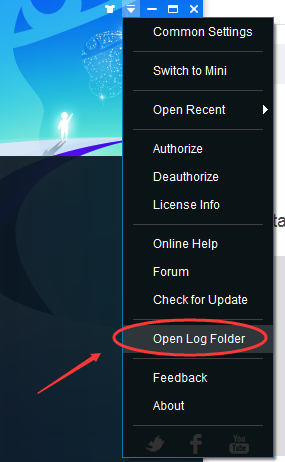

      Please post dvdfab_internal.log file and fabcheck_internal.log file. You can refer to the image attached for info about locating DVDFab log folder.
Name:	open log folder.png
