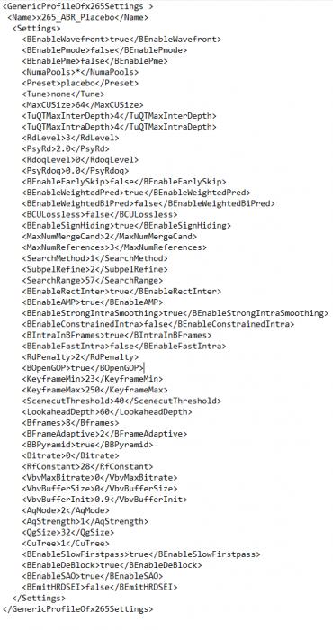

    I have been trying to modify the presets and profiles that are in the program files for DVDFab 11.0.5.1 (Always Up to Date). Unfortunately every time i make a modification to any files or create my own presets and profiles, I see no difference from the original rips that use the default profile and preset. I am trying to rip at different x265 speeds as the default is medium and I would prefer to use 'placebo' or 'veryslow' presets for my rips. I have referred to (https://x265.readthedocs.io/en/default/presets.html) for all of the setting options. Is there something I am missing?

      So I tried only modifying existing presets and profiles at first, but it wasn't changing my rip outputs from the original settings. The second thing I tried was making independent copies of the preset and then renaming it (both the file name and the name in the preset file) and then created a new profile that tied back to the preset for the encoder properties as well. The profile i used was a copy of the non 4k 10bit mkv profile that was unmodified other than the preset name line, and the settings that were changed in the preset were only the differences that the placebo preset had in the x265 site listed above. Are there any other changes that need to be made in the program files?
        This is the preset I am trying to use with my changes:
        <GenericProfileOfx265Settings >
        <Name>x265_ABR_Fast</Name>
        <Settings>

        And the profile that I have modified the video portion of to reflect the preset above:
