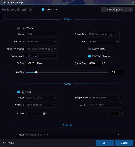

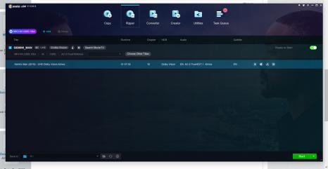

    I updated to the latest DVDFab version 11.0.6.9 and ripped the UHD disc of Gemini Man (2019), using MKV.4k.H265.10bit like I do for all my UHD's, but when it finished the file size was 43gb!
    So for whatever reason, it essentially copied the movie with no conversion. I expected to see a file size around 16gb. So I'm going to go back to version 11.0.6.8 and see if it happens again with this title.
    I'm attaching the internal log and some screenshots if someone could take a look and see what happened, I would appreciate it.

    From the capture of the advanced settings page it looks like all of that is correct. You might try it with one pass instead of two. The first capture of the open source screen is not legible and not really needed here so I have removed it. Do you normally set the encoder bitrate at that level?

      I always use 2 pass with .1 as the bitrate.
      I'll try again with 1 pass and see what happens. I'm wondering if it's a problem with this movie since, both of the last DVDFab versions did the same thing.

        I just tried using 1 pass with 11.0.6.8 and it did the same thing as 2 pass, it copied the movie with no conversion.
