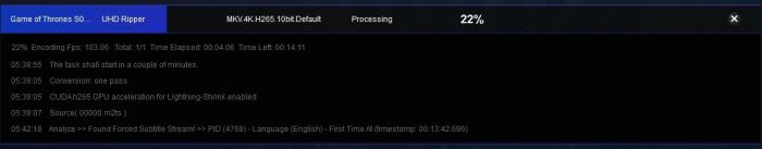

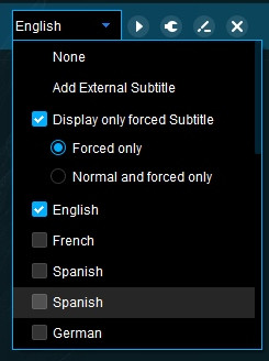

    I'm trying to rip the last episode of Game of Thrones and I can't get the forced subs to show up in the resulting mkv. Fab recognizes the forced subs because I can see when it analyzes them during the ripping process. But the forced subs don't show in the mkv. The settings in the picture attached are what I tried last and didn't work. What do the sub settings need to be to Direct Render the foreign language forced subs but remux the regular subs?
    Can anyone tell me the settings I need to use to get the forced subs to show up in the mkv?

                  Unfortunately that didn't help. The forced subs still aren't showing in the mkv after the rip. I've attached a screenshot showing that Fab recognizes the forced subs and the log.
                  Should I leave that option checked to "always display only forced subtitles" or should I go back and uncheck it? It's been unchecked for years but the forced subs have always worked until now.
