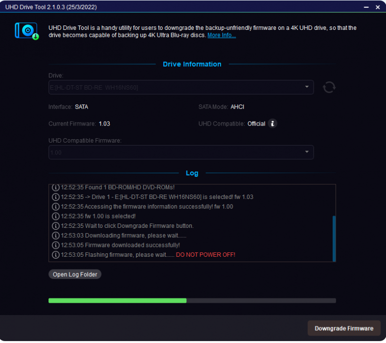

        Hello, I am downgrading the firmware 1.03 of my new LG WH16NS60 purchased from Amazon, and it comes with firmware 1.03, the issue is that it takes more than 50 minutes with the progress bar in the middle, it is normal or it may be stuck. Attached log. Thank you

          Two hours later, it's still in the same place. I'm afraid to turn it off and I know the recorder is wrong. What I do? Thank you
            I recently purchased the same model from Amazon. The 1st one they sent was defective and I exchanged it. The replacement worked fine and the software to pull it back to firmware 1.00 worked fine and it did not take very long to operate. I expect 2 hours running indicates something is terribly wrong.

              Finally I had to cancel the process, since it was not advancing and it had hung, on the second attempt everything went correctly and the firmware was downgraded to version 1.0. Thank you
                Excellent. My drive with the lower numbered firmware has worked just fine so far, so hopefully yours will also.
