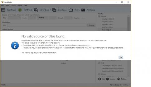

                  thank you for checking it out and sorry for the delayed answer. Here is a screenshot of Handbrake after trying to open the mp4 created by DVDFab ;
                    Hello Sannom,
                    Thank you for the update, I will have the developers look into it.
