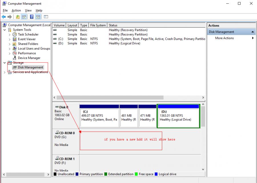

            my computer using windows 10 do not recognise the HDD.
            Insert HDD to windows -right click my cumputer button-Manage
            Choose Disk Management , you can see you new HDD , right click to format it
            Format it ,make sure it has a volum lable
