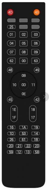

      @aggie113
      Did you find the remote code? Here is a code picture.

          Originally posted by Dora View Post
          @aggie113
          Not sure what this is for...
          Trying the VidOn v200 option listed under the Harmony software now.

            Maybe you can try the Egreat A5/A10 option listed under the Harmony software.
            Because the Box is manufactured by Egreat.
