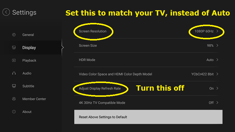

    Please check your settings for the display in Advanced Settings on MS and also your TV's current settings for the display size and refresh rate. I can't duplicate the problem you are seeing. There are several settings that can impact the HDMI negotiation. I will add some captures to illustrate the points you should check.
    First, look here and change Screen resolution to match your TV settings instead of Auto and turn OFF Adjust Display Refresh rate.
    Click image for larger version  Name:	1-011 MS DISPLAYSET.png Views:	1 Size:	53.4 KB ID:	343976
    If this does not help there are a few other things to try.
      Thanks Signals! I believe that worked.
        I'm assuming I would have to switch back the screen resolution if I wanted to watch some 4k youtube videos?
          You can change the box output resolution to 4K 60Hz
            The main point is not to select Auto for now, it does not seem to work well with your TV. On my unit the delay between punching play and playback starting is very short, ~200 ms.
