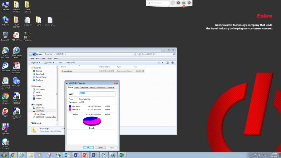

          I've now used a different PC to download to a USB drive. This time it's a Windows PC. Again It won't load to the MS. I'm attaching a screenshot of Windows Explorer showing the USB drive data. There is only one file on the drive and it's in the root directory. This USB drive is formatted to ExFat.
            #35
            Rename it to just update, If you rename it to update.zip its really update.zip.zip as the extension name is hidden, first time I ever tried updating mine I renamed to update.zip and it would not show on the MS. If you rename it to update it should still show as a zip file like you screen grab, if so then you should be good to go.
            Try that and plug it in the MS when turned off, After the MS boots you should see a pop up about USB update detected.

              Part of the problem is under settings in ms. There is a setting that which says hide all known extensions. You will have to un-tick this box to show all extensions. The same goes for all hidden files/folders.
              Win 8
              goto control panel
              select Appearance and Personalization
              Select folder option
              select view
              and you can't miss it
              Win 10
              goto control panel
              select file explorer options
              select view
              Enjoy

                  I did have it named just update.zip and not update.zip.zip. The file extension shows in Windows Explorer when you have detail list selected which I did. Anyway I tried with 1.0.3.1 and after it initially gave me an error with the Android toy running, when it restarted it found the update and loaded it so I'm good now.
                  Thanks for everyone's help.
