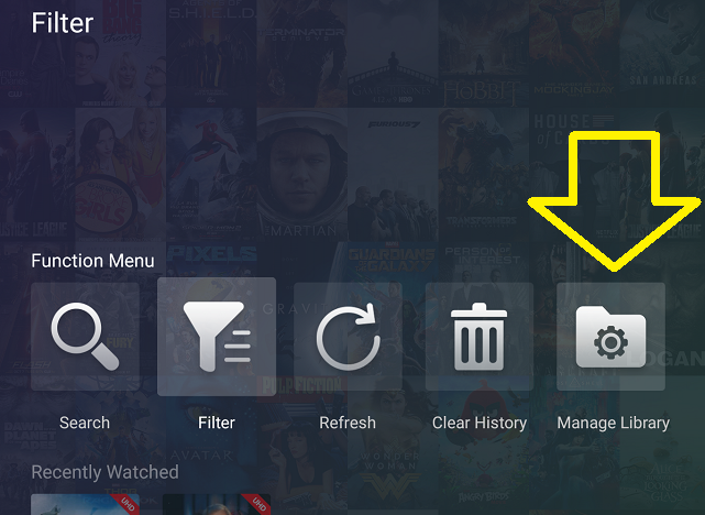

        Hi Ken, it is 'Nightwatchman' in colloquial English . For the the problem with the paths, you can edit/remove/update them using the Manage Library tool, which you can access from the Poster Wall by pressing the 'Up' key on the remote (see captures below). For the 'DMS not found by DVDFab' issue, please follow the suggestions in this post: https://forum.dvdfab.cn/forum/dvdfab...747#post363747
Name:	1-011 LIBMGR.png
Name:	1-011 LIBMGR2.png

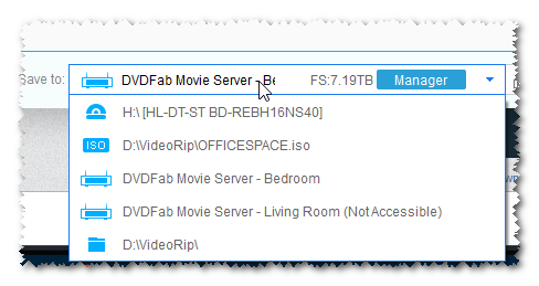

          Oddly enough, when I launched DVDFab 11 this morning it properly found the server for the very first time. It still has two listings and the "Living Room" is the wrong one, but the Bedroom one connects. However... Clicking Manage does take you to the DMS web site instead of the local IP.
