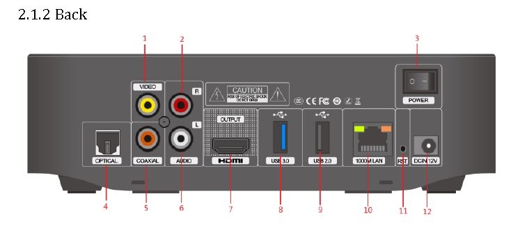

    Holding in the reset button (11) on the back while turning the power switch (3) on doesn't work ?

      These are almost impossible to brick, try what Dead Eye suggested.. If that does not work, download a fresh copy of v2.0.1.0 and put it on a usb drive, power off the DMS, plug the jumpdrive into the USB3 port, then turn on the power. Should boot and recognize the drive and allow you to update. Be sure to check the MD5 of your new download of v2.0.1.0: MD5: EFDC59566069DB807E9C45852CBDB39E
        Okay - thx for the help - worked fine and i am back on 2.0.0.8 - will try the new one later ...
