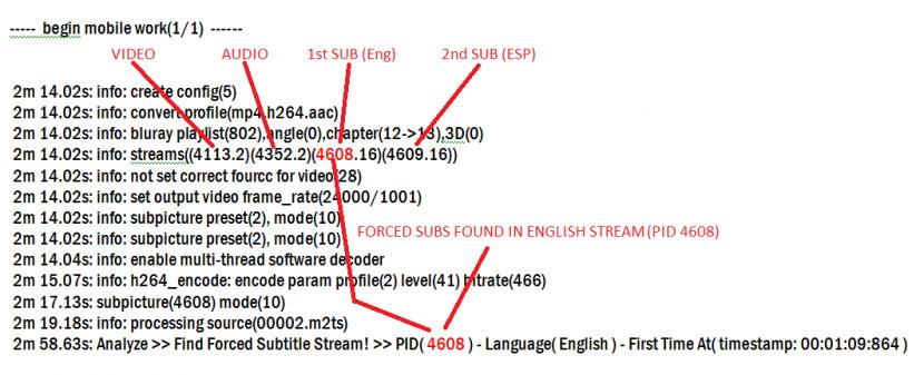

                  It works with any recent version of DVDFab BD Ripper, say from about a month or so ago onward. Here is the best way I found to use it:
                  If you suspect the movie might have forced subs (lots of translations necessary) you will need to make a test conversion of a few chapters using Blu-ray Ripper, set to a profile that allows more than one subtitle stream. I used the MP4 h264.aac profile. Go to the sub stream selection window and put a check mark in the boxes for the streams you think may contain the translations. Set the frame size to something small like 480x270 to help speed this up. Press Start and let the conversion run until it finishes, usually just a few minutes. If there are any forced subs, you will see them identified in the process window as the conversion runs.Click Finish in the DVDFab window. Now go look in the DVDFab \Log folder for the internal log, which you can open with Notepad. The log for the test conversion will be at the end of the file and should look like the one in the attachment, which shows you how to determine which stream had the forced subs (in this case, it was the first one on the list with a checkmark, as shown).
                  This is a cumbersome process but it works. My test movie was the original Blu-ray of Avatar. Hopefully the developers can be convinced to make this a little easier and more user-friendly.
                    Signals, I followed your steps for Avatar Extended and when I looked at the log I didn't see where it said Analyze find forced subtitles instead the log said:
                    ------ begin mobile work(1/1) ------
                    16m 38.95s: info: create config(5)
                    16m 38.95s: info: convert profile(mp4.h264.aac)
                    16m 38.95s: info: bluray playlist(3),angle(0),chapter(3->5),3D(0)
                    16m 38.96s: info: streams((4113.2)(4352.2)(4608.16)(4613.16))
                    16m 41.77s: info: not set correct fourcc for video(28)
                    16m 41.77s: info: set output video frame_rate(24000/1001)
                    16m 41.77s: info: subpicture preset(2), mode(10)
                    16m 41.79s: try to use gpu acceleration(1) for video decoding
                    16m 41.79s: CUDA GPU acceleration for video decoding enabled
                    16m 41.79s: CUDA GPU acceleration for video encoding enabled
                    16m 41.79s: info: h264_encode: encode param profile(2) level(41) bitrate(3315)
                    16m 41.88s: subpicture(4608) mode(10)
                    16m 41.90s: info: processing source(00049.m2ts)
                    16m 46.95s: info: processing source(00002.m2ts)
                    19m 41.38s:
                    ------ finish mobile work ------
                    As you can see it shows a subpicture (4608) mode(10), what does that mean?
                      It means there are no forced subs in the two streams you selected, at least not any it could find. They may be handling the translations a different way on this disc.
                      Use the small preview window in DVDFab and play the title, switching between the sub streams until you find the right one, or turn them all off and see if the Navi speech translations may be burned into the movie video. (Right click on the preview screen while it is playing to select a different sub stream.) You might also test it will all codecs set to Software (no GPU).
