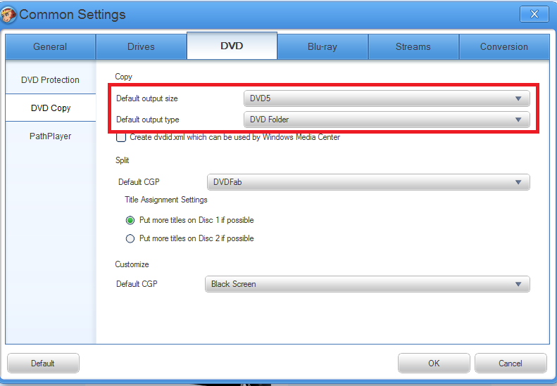

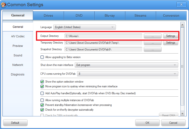

    It should already do this. The "Save to" field at the bottom of the window is a dropdown with previous targets listed, but it does not populate until a Source is loaded. If you want it to default to a particular format and drive each time, first set the drive (and folder if desired) on the Settings->General tab, then select DVD (or BD) Folder as the default output type in Settings->DVD->DVD Copy. You can also set the default size (i.e. compression on or off) on the same page.

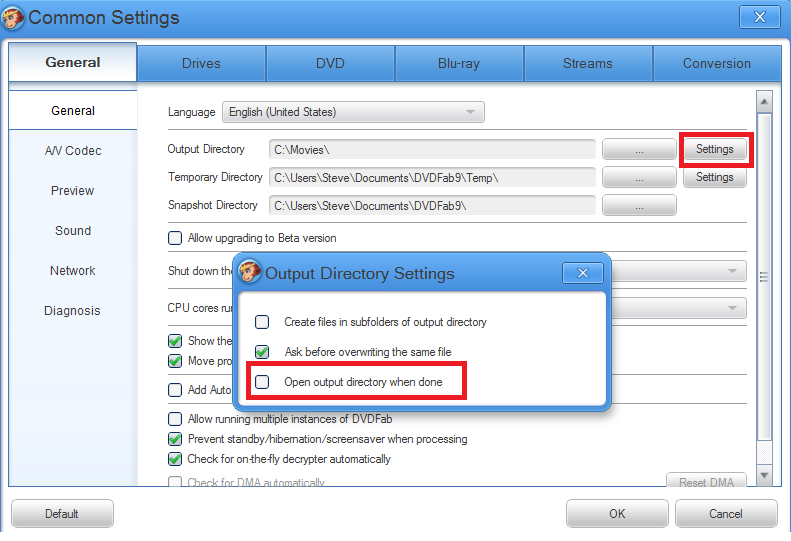

        At one time there was a checkbox to open the output directory when finished, but I can't find it either now. I will check with the staff when the office reopens later.
          It's right here:
            Aha! Thanks.

              The default it tries to go to is the optical BD burner. I always have to pull down the list and change it to the folder that I use. The value in the general settings goes to a folder in the "Documents and Setting" area, which is not what shows up in the target.
              DVDFab8 does remember the target location, DF\VDFab9 does not.
                Set these two items and it will always copy to a folder of your choice by default.
                  Actually it is three items, as you have to do the same under the Blu-ray tab.
