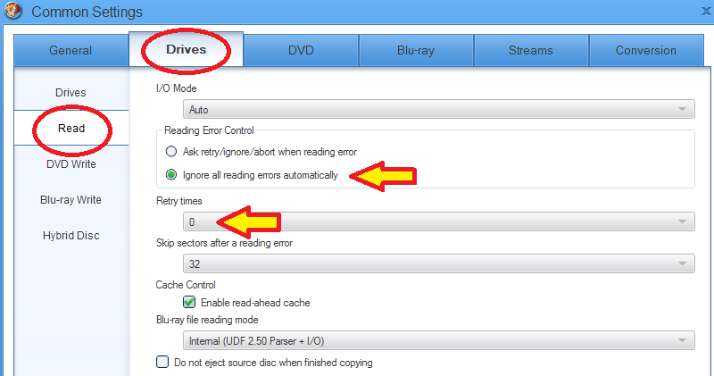

    You set that here:

              Have you tried the settings shown in the capture?
                Signals:Just so we are on the same page here I am able to make a 50 gig iso of a disk without errors or any errors in the log file on two different 3d disks that i have a problem with.Logs attached disregard the star trek stuff as i had a job going on still so i could do these logs in a second opened fab program.Now you have new log files with the latest Fab version 9.They don't speak of any errors.

                So a player in this case power dvd 11 sometimes will skip over or hang a second a then keep playing.So we know theirs a bad spot in the 50 gig iso that the encoder doesn't seem to be able to skip over although i tried your latest settings exactly but they didn't work.No other setting in software has ever worked for this type of error or deep scratches when making the Iso.

                    hehe wrong. The settings I showed you apply to DVD and BD. Most questions asked here I asked long ago. Just a question of remembering.

                        I suspect because they have not tried the settings, which are extreme--you may well wind up with minutes missing, not a few frames, depending on where the scratch is. This would not be acceptable I think to most. A chance that better results would be obtained by setting the retries to a much higher number, like 8 or 9, and letting it grind on it for a while. This would minimize the missed video.
