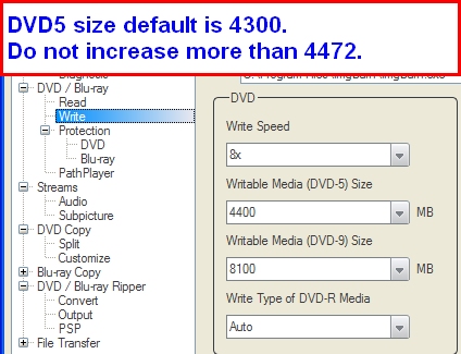

          In regards to the compression what is you quality size set at now?
          For more compression change to a lower number. See attachment.

              It's set on 4300 for DVD5 and 8100 for DVD9

                You can set it as low as 4000, but not lower. Use Customize in the DVD-5 size selector drop down.
