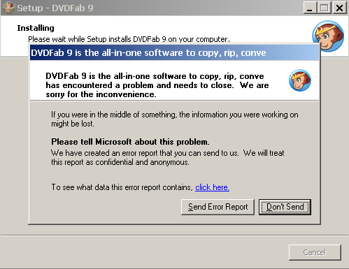

    In my experience 9.0.6.3 was the last version which works OK with Windows XP. Although 9.0.7.2 installs without apparent errors, it will not run. Then the latest 9.1.0.5 causes an exception during the installation. Although it apparently installs the files OK into C:\Program Files, it will not run - causes same exception message (see graphic).

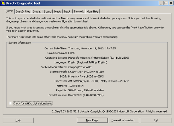

          One clue would be to run "dxdiag" click the display tab and post a screen shot.
            Done...
            Last edited by Eddie13; 11-15-2013, 12:20 AM. Reason: trying to post graphics despite sluggish server...
              That's the system tab, let's look at the "Display" tab.

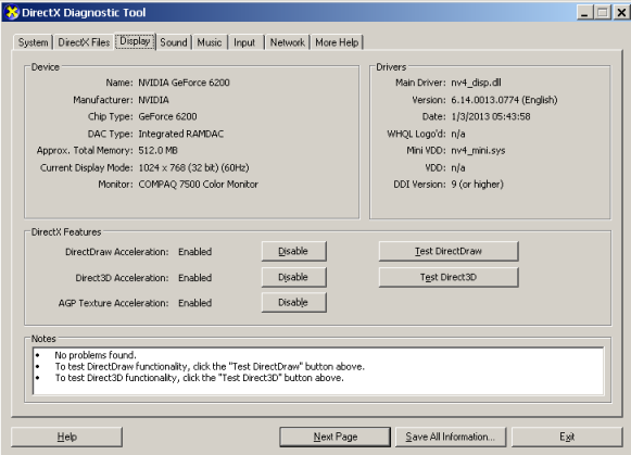

                  All the DirectX features are disabled, see if you can get them enabled and it might make a difference.

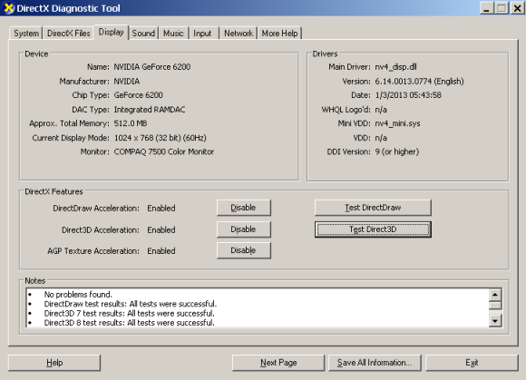

                    Why do you say they're disabled?
                    They appear to be enabled to me!
                    Here's the Display tab after running the tests...
                      You're right I was looking at the wrong column. I guess the API to decode the graphics is not supported by DirectX9.0c or your graphics It's a problem I had with XP on a laptop. I installed Windows 7 and all is well.

                              I updated my NVidia display driver to the latest recommended version (Feb 26 2013 driver 307.83) which didn't help, same exception when DVDFab 9.1.0.5 is installed on Windows XP SP3. It appeared to complete most of the installation but the exception happened before it could ask that computer be restarted. I restarted manually which didn't help, still won't run, same exception message. There is no associated log file.
                              I couldn't print a screen picture of the following exception info (wouldn't copy) so transcribed part of it below. It along with the attached 2b06_appcompatibility.txt file were to be sent to MS with the error report (not sent). I don't claim to understand it but maybe it will help your tech department troubleshooters.
                              Error signature
                              AppName: dvdfab.exe AppVer: 9.1.0.5 ModName: qt5gui.dll
                              ModVer: 5.1.0.0 Offset: 00001010
                              Exception Information:
                              Code: 0xc000001d Flags: 0x00000000
