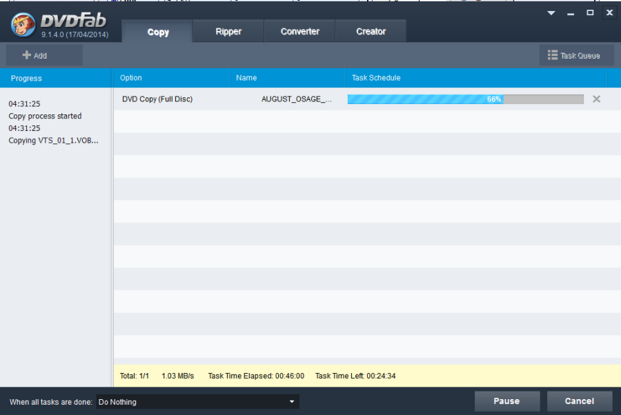

              9.1.4.0 works with XP but very slowly
              I'm delighted to find that the latest 9.1.4.0 version installs and runs on my XP computer, so the CUDA GPU fix worked! I have a NVIDIA Geforce 6200 card.
              There is also a special patch that had to install (as notified by the 9.1.4.0 installer) because my processor does not have SSE4.2.
              Unfortunately it runs very slowly and uses 100% of processor, making computer sluggish, so I had to lower priority. Something is not right yet...
              For example I tested copy of a simple unencrypted unprotected single layer movie (4.7GB) and it takes about an hour simply to copy it from disk to hard drive folder. It should only take about 5 minutes at most. The maximum copy rate is about 1 MB/s which should be 20-30x faster. It's as if it were using the non-DMA speed of my IDE optical drives, but I reset them manually to DMA so that doesn't seem to be the cause.
