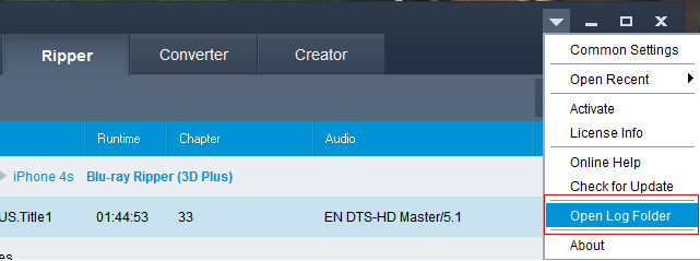

    Please post a DVDFab internal log from an iPad conversion. I have not used Ripper since installing the new version. If you have the free MediaInfo tool, post or attach the results from one of the output files after MediaInfo scans it.

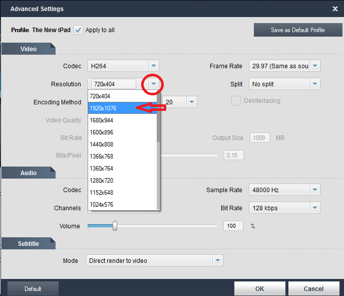

                  You can select the resolution, see attached:

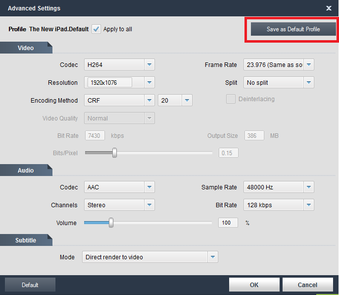

                      You don't have to set the resolution every time, set it and the desired bit rate and click save it as default and OK and it will be there every time from now on. I understand they changed the default frame resolution in the profiles and it threw you a curve. See attached:

                              Since upgrading to 9.1.2.2 I also cannot rip any video for my Iphone 4S without manually tweaking default parameters. As mentionned by the original poster, the profile for all apple device seems in error.
                              Hi, Grinless
                              What kind of video source you're using? DVD or Blu-ray .
                              9122 version of the Apple Profile file just modify the output video resolution ,
                              Video resolution changed to automatically calculate based on video .
                              Please put your dvdfab_internal.log paste here .
