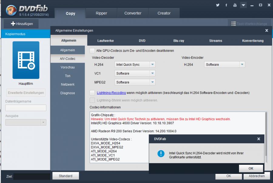

    Hello,

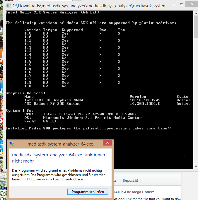

    I used DVDFab with Windows7 and my CPU and my NVidia without Problems. Now i switched to Windows 8.1 Pro with Mediacenter with a R9 290x from AMD. I installed DVDFab again and startet to activate my integrated GPU, hooked the Intel to a monitor but no quicksync in DVDFab. I even set the Intel as main GPU, did not work. I used the mediaSDK Analyzer, but it crashed.
    Check the screenshots.
    Has anyone a guess how to fix this?

      The latest driver version 3907 is released at 2014.08.29, maybe does not support in DVDFab. Please roll back to the old driver 3621.
      We will check and fix ASAP!
        #33
        Thanks,
        The old driver is working.
