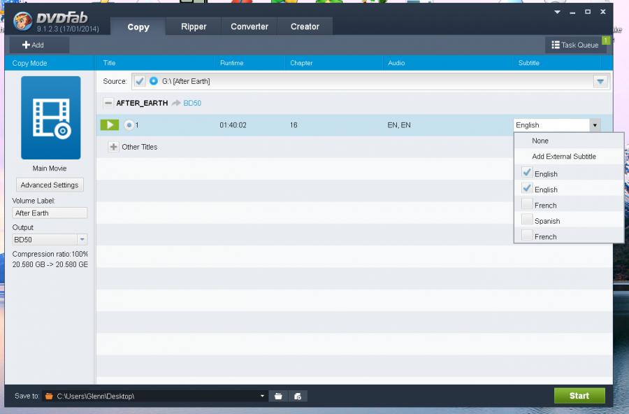

                      90312& Signals can you confirm version 9123 has a default arrow for setting subtitles as mine version 9 doesn't have a default arrow to set sub titles see my screen shot.Their is a arrow for audio tracks.

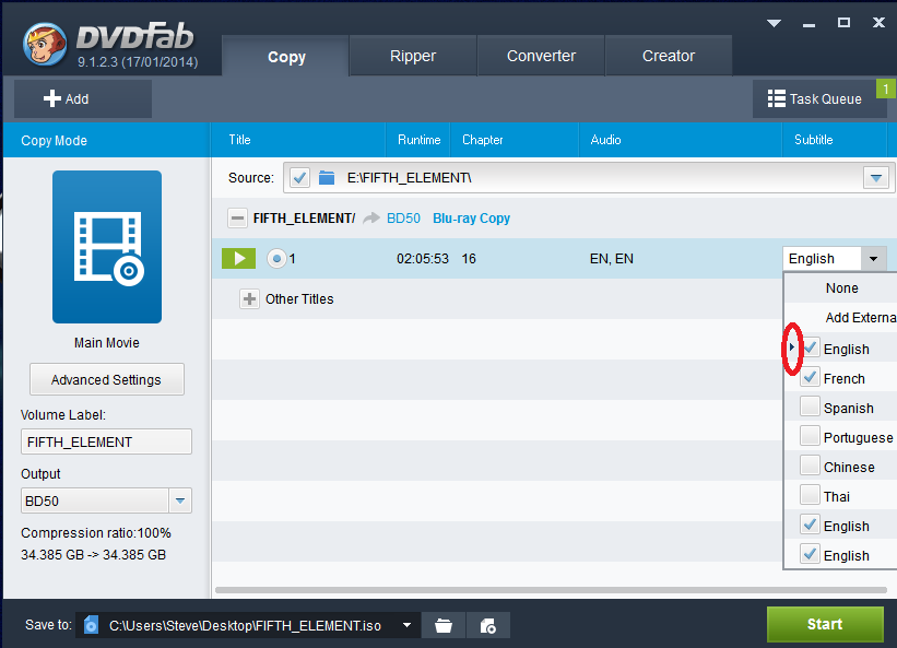

                        I noticed 9.1.2.3 does not select any subtitle as default but you can click in the area of the tick mark and select one yourself:

                            The default arrow is still there but it has gotten very small. The file that 90312 is playing did not have the default arrow set, he sent me the IFO files and the "on" pre-command is not there, so it must be some sort of player issue.
