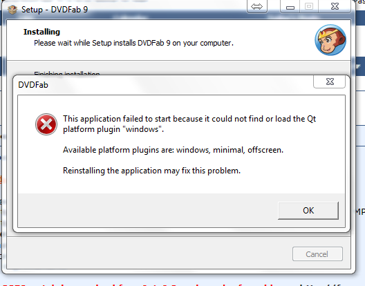

    Routine upgrades from 9.1.5.9 are failing with the same issue immediately post installation.
    Both 9160 and 9161 upgrades give an error message claiming the programme could not load or find "Qt platform plugin 'windows'". It then recommends re-installing.
    I end up un-installing DVDFab altogether (keeping preferences) and then reinstall 9159.
    It's a issue for me at the moment as I cannot do "2" pass rips due to the defect fixed in 9160.
    Any clues as I cannot see the issue in the forum even historically.
    Image attached as there are no logs I'm aware of for the issue.
    What is your OS and version? There was an update to Qt that was first in 9160 I believe.

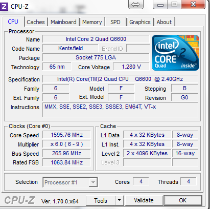

      requested Sys config
      Running 64 bit Win 7... chipset handles SSE screen shots for both attached as requested.
      I read the SSE instruction but since I have it I have not touched that patch.
        You should not need the patch and I don't recommend you try it. I have the same OS and have not noticed this in 9160 or 9161, so it may be related to a Windows update or the version of some other OS component. I had to roll back a NET framework update a few months ago due to problems with several applications. I will relay this to the QA Team in Beijing for further testing.
