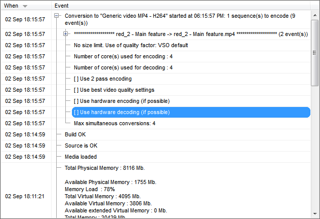

        • #34
          How do we know that CUDA or IQS is used in VSO Video Converter?
          From the log events?
          Support IQS and CUDA on my PC. I convert a DVD ISO to h264 mp4 format that IQS or CUDA will be used in DVDFab.

          • #35
            Hello
            I have been talking to their technical support. They just created a new beta which they asked me to test that includes an updated CUDA for the latest driver.
            When using this version, under settings I have two options - Use Hardware decoders and Use Hardware Encoders (nVidia CUDA). I only have the encoder ticked.
            When you run an encoding the speed of the encoding is greatly increased, from this I can only conclude that CUDA encoding is working.
            I am trying to locate my previous quadro driver and will rollback to see if the speed of the encoding changes with that in comparison to the latest one.
