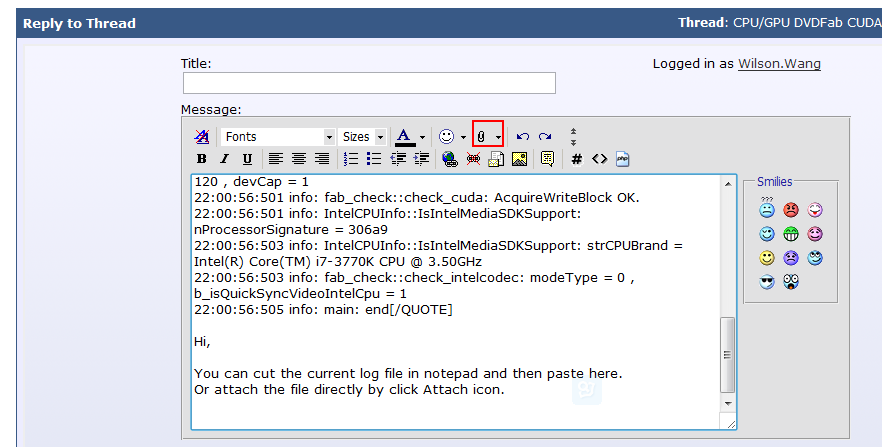

                            DVDFab internal log file is also needed.
                            You can cut the current log file in notepad and then paste here.
                            Or attach the file directly by click Attach icon.
                            For DVDFab9_Win7 & Win8 C:\Users\User Name\My Documents\DVDFab9\Log
                            For DVDFab10_Win7 & Win8 C:\Users\User Name\My Documents\DVDFab10\Log
                            For Mac: /User/User name/Documents/DVDFab10/Log
