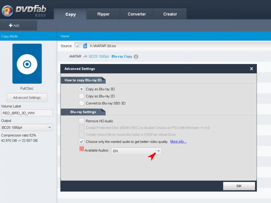

          If you used the new feature in Fab full disk to 25 gig. did you click on advanced settings and select the audio tracks you wanted to keep as in the picture?

              You need to check the audio tracks you want to keep in the pull down box not the ones to get rid of.Look at my picture again in my last post.

                I checked Advanced.
                I had the advance settings like this
                (checked) Choose only the waned audio to get better video quality
                available audio
                (checked) English AC-3/2
                (checked) English DTS-HD Master/5.1
                (checked) English DTS-HD Master/6.1
                OK

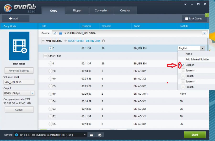

                    When you establish what audio stream you need you can move the arrow head I have circled by clicking adjacent to the desired, checked audio stream and it will play by default. No need to select via the menu.
