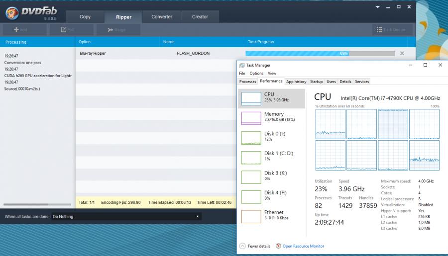

            This might give you an idea on CUDA performance with DVDFab. This is done with a 980 card but if the 960 is any slower it won't be significant. Note the CPU is loafing at around 20% the lion's share of the work on the GPU.

                  The 960 will decode H.265 on the GPU witch will be important when BR discs start using the codec. DVDFab uses CUDA very nicely. My GTX 980 will encode a BR to H.265 in less than 10 minutes. I never got my AMD card to work with Fab at all.
