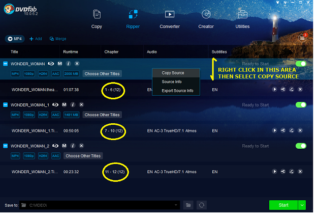

    The ability to get individual episodes depends on how the disc is authored. Some DVDs have only a single title (the Play All option on the disc's menu) and so will produce this effect when processed in Ripper. These discs generally splt the episodes up by chapter rather than having an individual title for each one, so the solution is to use DVDFab's chapter splitter to select the individual episodes. You will need to use the Preview function to see which chapters for the episode boundaries. Here is a capture that illustrate this procedure. This one is for the Ripper module but Copy works the same way. After selecting the chapters for the first episode, use Copy Source (as shown near the top, it is a context (right click) option that reloads the same source to let you select the chapter range for the next episode.
    Click image for larger version  Name:	1-011 COPYSOURCE.png Views:	2 Size:	257.1 KB ID:	345874
