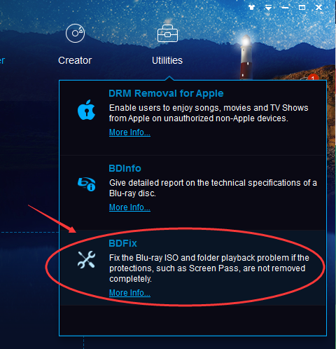

    To repair the Blu-ray folder/ISO, you can give BDFix a try.

          It is in the DVDFab 10 installer. Start up DVDFab 10, go to Utilities and choose BDFix in the dropdown menu, it will bring up the BDFix window. You can refer to the picture I posted in the previous post for info.

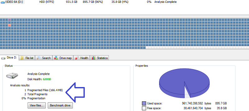

                    My system is a not so sophisticated one which I began using several years ago. I purchased a USB dock for internal hard drives and began buying 3.5" hard drives whenever they were on sale. Most of the early ones are 1-2TB WD Black or Seagate Barricudas, more recently larger ones as the prices have come down. I have attached a Defraggler scan of one from about 3 years ago which is typical. DVDFab is set up to write folders to an internal drive, which I then transfer to the long-term storage drive as described above. I realize there are improved ways to do this now, but this has worked pretty well for me. Defragging a drive with lots of multi-GB m2ts files is truly a fools errand. DVDfab's BD-Fix utility is useful primarily for volumes that were not properly decrypted initially, I don't think it would be useful for corrupted files. Sympathies for the failures you suffered!
                    Click image for larger version  Name:	1-011 FRAGS.png Views:	1 Size:	89.1 KB ID:	349517
