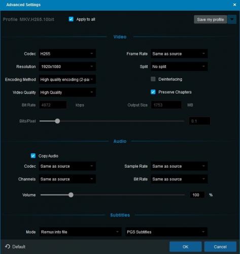

doing the encoding at 1 pass normal and high quality produces a file no problem, use CUDA engine and episode finishes in a couple minutes. but output looks like garbage compared to 2pass high quality (cpu encoding). frankly even CRF 30 high quality looks worse then 1 pass. and rightly so. it produces a slightly smaller file which means lower bitrate. I need this to work using high quality 2 pass.
I did a full uninstall and delete of the dvdfab folders, redownloaded the latest 10.0.9.0 x64 and installed it. kept every single setting at default, except the quality settings of course for testing. its encoding @ 2 pass high quality right this second
so only thing i've touched it switching from default single pass to 2 pass high quality, and copy audio and also remux subtitles into file

and again same result with my laptop, no output. 2 pass. everything left default but high quality and copy audio and remux subtitles into file. log files attached and also screenshot of quality settings
