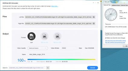

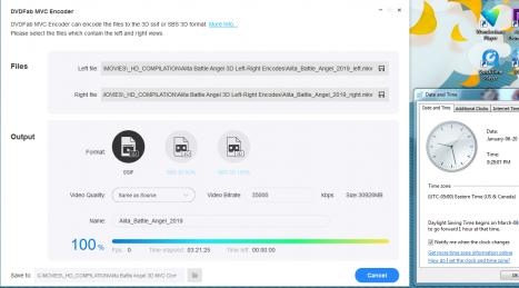

        I did a few more tests with Geekit MVC Encoder and it appears that no matter what I do version 1.0.0.4 will crash before completing the task. The 2 screenshots below I took specifically in a span of time so you can see that the software just sits there at 100% doing nothing.
        When reached 100% you can see on the clock it's 9:28:07 PM

        I took another screenshot at 11:04:17 PM and Geekit still sits at 100% and there's no completed message. Please note that on both screenshots the Fps is 0, Time left is 0 and Time elapsed is exactly 03:21:25 which clearly shows the software is not doing anything.

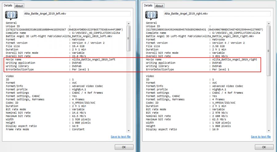

        For the input files I tried a few different tests but the end result is always the same. For the first test I input left/right eyes compressed by Ripbot264 and made into MKV by mkvmerge v38.0.0. The left eye with chapters only. For test two I used mkvmerge v38.0.0 to add an audio file thinking that perhaps Geekit doesn't like if there isn't at least one audio stream. Finally, I ran the left/right eye encodes through DVDFab Video Converter using the MKV pass-through profile rationalizing that maybe there's something in the MKV created by mkvmerge that Geekit doesn't like but sadly that also made no difference. I'm attaching a screenshot of the meta info that shows the MKV has in fact been created by DVDFab.
