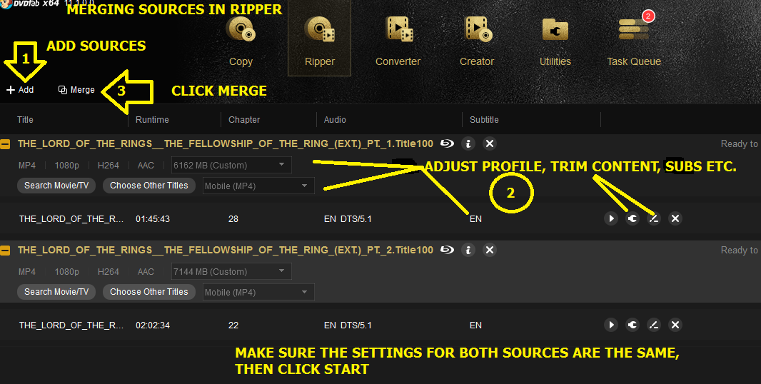

    I bought the Lord of the Rings Extended Edition. Every movie is on 2 BD.
    I rip now bouth BD to mp4.
    How can i merge the 2 mp4 together?
    Or is ther another way to rip 2 BD to 1 mp4 file?
    Thanks for the Help
    Stivi
    You can do this easily using the Merge function in the Ripper module. Follow the steps outlined in the screen capture and post again if you have problems or questions.

      Hi signals
      I have only 1 BD Drive. If i put the first BD in it then i see the top part. but if i then put in the second BD then then the top part disapiear.
      How can i handly that?

        Hi Stivi, for Merge mode in Ripper or Copy, ALL Sources must be available at all times until the Merge is complete. The best solution is to use Copy mode Main Movie to copy each title to a BDMV folder on your HDD. Then run Ripper Merge using these two folders as the Sources. This will also allow Ripper to run faster than using an optical disc for the Source. If you have more than one HDD, use different drives for Source and Target for even more speed improvement.
        For these titles, you will probably want to crop off some of the very end of part 1 and very beginning of part 2 to make it look like it did in a theater (remove “Continued on disc 2” etc). You can do this in Ripper very easily by clicking on the icon that looks like scissors before you start the Merge.

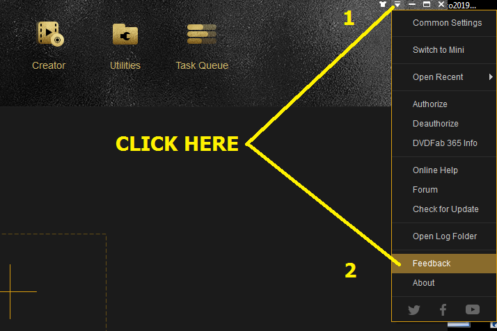

              shuegli65 I had no similar problem. Please find the DVDFab Feedback button in Settings and submit the logs using that method, no size limit. It will provide you with a Log ID number, please copy it and report it in this thread.

                Hi Signals
                Here the Feedback Number
                9517889
