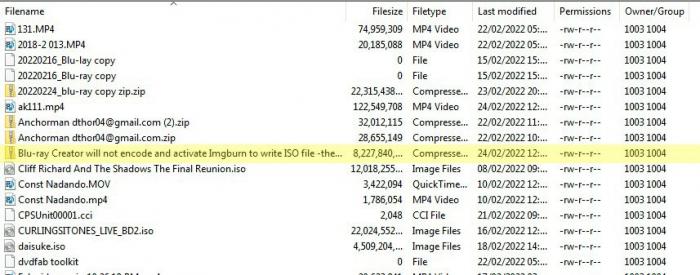

Name:	Screenshot 2022-02-24 120348.jpg
          Hi Mona,
          Location of uploaded MP4 file (as requested).

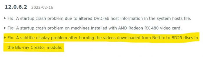

                        v.12.0.61. https://d17.dvdfab.cn/download/58_12..._x64_12061.exe
                        It's blatantly obvious there is a major problem with DVD & Blu-ray Creator post v.12.0.6.1. This coming off the back of the change implemented in v.12.0.6.2. concerning the (only) change made to the Blu-ray Creator software and subtitles in this version. And since this version -it ain't workin'...
