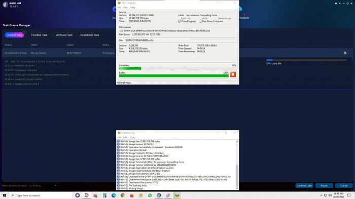

      Alas v.12.0.6.4. remains "broken" for me in Blu-ray Creator -fails to activate Imgburn to write ISO file when the encoding process reaches 100%. Instead it just sits there and progresses no further. I have uploaded log files, sent MP4 files to DVDFab, even screen shots ... To absolutely no use whatsoever. Q&A Team state they are unable to replicate the issue -yet an issue IS THERE! v.12.0.6.1 works perfectly, all proceeding versions do not!!
      Screen shot of Imgburn activated using v.12.0.6.1.
      Click image for larger version  Name:	Screenshot 2022-03-10 064611.jpg Views:	0 Size:	27.8 KB ID:	407224
      Log v.12.0.6.1.zip Log v.12.0.6.4.zip

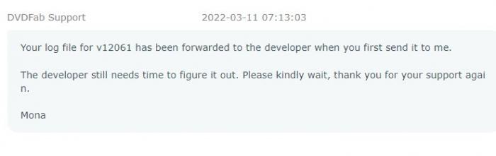

          I use the exact same method and procedure as yourself my friend and end up with the exact same results -failure. Which lends even more credibility (and weight) that the issue is software related. Did anyone from DVDFab support come back to you with regards to all the log files etc that you sent them? I again have sent Mona through the 'ticket' system both logs for 12.0.6.1 and 12.0.6.4. after going through the process of trying to write an ISO using Imgburn in both versions. Mona has said she is sending the Developer the logs for the latest version, but hasn't indicated whether she is also supplying them with the logs (supplied) for 12.0.6.1. for comparison purposes?
          As frustrating as this is as our mutual efforts in trying to provide as much 'evidence' and data possible to help find a 'fix' appears to be falling on deaf ears with the Developer and Q&A Team, I'm just relieved that Mona is the customer support agent who's taken charge in being the liaison here. Mona does what she says she's going to do (and) does genuinely try to help, where I've found the other support agents merely give you the run-around or just can't be bothered!

                  Cheers for that lesson dude, mucho appreciated. I'll stick with what I know works for me in regards to file creation and that's ISO and Imgburn. But thanks also to alliyance for his valuable input -always welcomed. As for '..where is Mona..' She's on it dude, she's on it...
Name:	Screenshot 2022-03-13 062659.jpg
