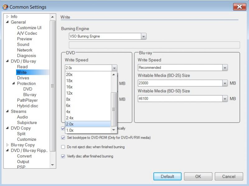

    I always seem to change burn speeds to 2 or 1x, but defaults of some kind always seem to kick in when burning time comes... is there a way to set a burn speed at 2x and have it actually burn at that speed?
    Assuming you are using the VSO burning engine, set as follows:
      Was not using VSO.. had it set to DvdFab.

                    My disks are 2.4x and when dvdfab launches imgburn the write rate is aws . This results in 8x and i get i/o errors . If I launch ImgBurn directly and set speed to 2.4x it runs a 2.4x with no i/o errors. Problem is getting ImgBurn to use this speed when launched from DVDFab.
