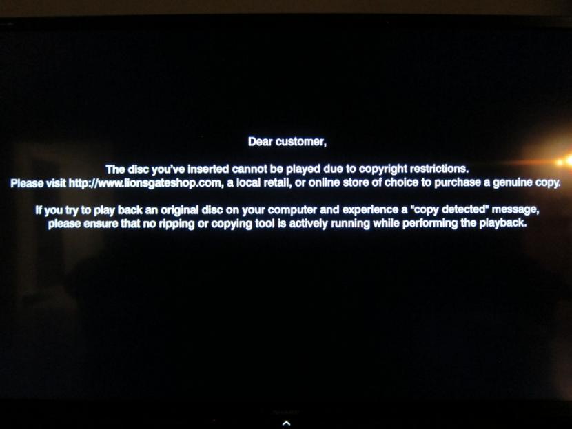

    I am currently on your latest 8.2.2.2 version and when I attempt to play a copy of Expendables 2 (used the Blu-ray Full option to create the copy) at the start of Chapter 3 I receive an error from "Lionsgate" that this is a copy protected Blu-ray. It is not a Sony Cinavia type error, but seems to be unique to Lionsgate. I will attempt to re-copy the original Blu-ray (luckily I made an .ISO clone of my original), but this time only select the Main Movie option.

      Region 1 and you are not offered an option for "Title" when one selects the "Full Disk" option.
      Since my original post, my work-around was to use the "Main Move" option. For that option, where the "Title" is an option, I choose Title 5 - and that copy worked fine. I chose the Titles that has for their times as 1:43:02 rather than 1:42:41 (Title 26) which was initially (the default) chosen by DVDFab. Clearly one want's to select a Title that has 1:43:02, as the are omitted / edited scenes on the 1:42:41 version. (The bar scene where Stallone and Statham, both wearing brass knuckles, hit this huge guy is NOT present in the 1:42:41 version - seems to be edited out)
      But I still believe there is a problem with the "Full Disk" option.
      Hope this update helps folks as they to circumvent the current ("Full Disk")problems with Expendables 2.

          Update - v8.2.2.4 does NOT correct the Expendables 2 playback issue. Attached .jpg image is what I get about 20 seconds into playing Chapter 3. The DVDFab team really needs to look into this. I am not wasting any more blank BD-R disks to be your beta tester. Your workaround, as I mentioned previously, is to use the "Main Move" option. Luckily the Full Disk version does not contain any easter eggs / deleted scenes, so you are not missing much by choosing the Main Movie.
