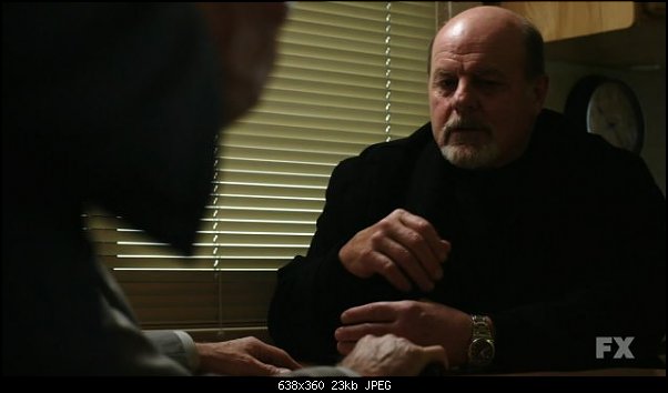

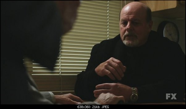

                        Just want to confirm does is this what you're seeing? Refer to levelsincorrect.
                        I was doing dark knight ( not shown here) and it seems to wash out the colors, especially black. What is even more interesting is it is not specific to movie. They all look washed out after encode by fab, even if all is done on CPU.
                        Then I use third party program and I do not see any color loss.

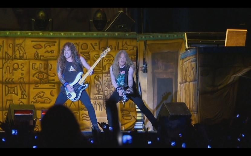

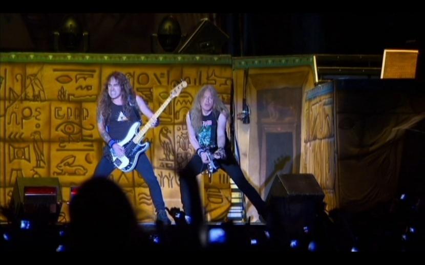

                              Hawk, sorry I erased full Blu-ray, but here's some snapshots.
                              The First one is Blu-ray encoded with DVDFab:
                              The second one is the same title, but from uncompressed DVD:
                              This is what I'm seeing, just examples to see a difference. Sorry if I did bad thumbnails, those are my first...
                              Also, I used third party program and I do not see any color loss!
