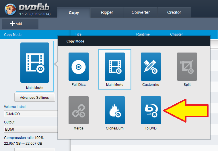

        I have the US version of the disc and will try it also. Blu-ray to DVD is also available in v9, see the attached screen capture for the location.
        The log in post #3 appears to be the same as the earlier one. And, yes, ATI video cards are problematic.
        Note that a BD-5 which you are trying to produce, is AVCHD format and will not play on a DVD player, it is just designed to fit on a DVD blank disc but still requires a Blu-ray player for playback.
          Thanks again for your reply,
          I restarted DVDFab, this time it finished in 2 hours 13 minutes, producing an .iso file of 71 GB. Something is obviously wrong. Maybe it has something to do with the ATI card, since there was no problem with 8.1.9.6 and the GeForce card?
          Thanks for the pointing out BD -> DVD in v9.
          BD5 would be great, as high resolution and graphic quality as possible in 4300 MB is great for me.
          I plan on maybe buying a new, standalone PC (haven't had one in 15 years) to be able to fit an NVidia GeForce 760 card. Can I expect a significant performance increase with the more powerful GPU card?

              You are welcome. I am not sure what you are seeing, I just made a test conversion of the Blu-ray using Blu-ray to DVD and it turned out great. I did not use the HD 7.1 audio as the source, this disc has 3 audio mixes, the 7.1 HD Master, a 5.1 version and a 2-channel version. I first made a Main Movie only rip to an external hard drive and kept only the 5.1 and 2.0 audio streams. Then I used the hard drive copy as the Source for the BD to DVD conversion using only the 5.1 audio, which DVDFab converted to AC3/5.1 for the DVD output.
              There are many purchase options with DVDFab which can be bewildering. It is done this way to allow users to buy only what they need at the time and for license terms from 1 year to lifetime. The product selector page has checkboxes for each module and a dropdown selector for the license term. Look over the website, there are several packages that offer discounts and there is almost always a coupon code on the homepage that you can enter to get 20% or more off depending on the promotion.
              Keep in mind that v8 is not updated very often and may not be officially supported much longer. There are features and tweaks in v9 that will never be in v8 because the GUI can't support them and v9 will also always have the newest decryption updates, which can be slow reaching v8. Any license you purchase will work both v8 and v9, and you can install both with no conflicts.
