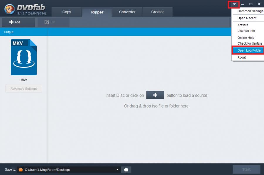

            Please tell me where the internal log file is and I'll send it. I used to know.
              You can find it like this:
                Here's the internal log:

                      Wilson.Wang,
                      The problem is that it won't load the Blu-ray disc.
                      All of the files in the My Documents/DVDFAB folder are:
                      dvdfab_burn_vso
                      dvdfab_internal
                      dvdfab_process
                      fab_burn_vso
                      I already sent dvdfab_internal. What, if anything,do you need?
                        Post the dvdfab_internal.log session that shows the disc that will not open. If you do not have a clean log entry that shows the entire process, please do the following:
                        • Close DVDFab
                        • Open DVDfab
                        • Insert the disc that won't open, wait at least 5 minutes
                        • If DVDfab can't open it, click Cancel and close DVDFab
                        • Open the internal log file with Notepad
                        • Select the last log session and highlight the text, right click and select Copy
                        • In Notepad, select File-> New
                        • Press Ctrl+V
                        • Select File->Save As and give it a name and location.
                        • Attach it to a post using the Manage Attachments button in the forum, beow the text editing window.
                          Problem solved. I decided that I had managed to corrupt Windows in some way causing the problem. Fortunately , I had made an image backup of my C-drive about a week ago. I installed it and tried to load a blu-ray into the latest version of DVDFab. It loaded and copied just fine. Now I'm a bigger fan of regular backups than ever. Thank you all for your attention and help. :-)
