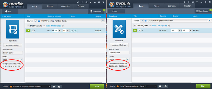

      Here is what I'm seeing, a 10 Gig difference in file size for the same 51 minute movie segment . . .

              I cleared all my logs as there were many and they were large. I then ran both Main Movie and Customize on the same 51 minute movie segment. The Main Movie process resulted in a 14.5 Gig file set while the Customize function resulted in a 24 Gig file set.
              It appears as though Customize included the about 34 minutes from the beginning of the original movie, followed by the 51 minute segment I had asked for.
