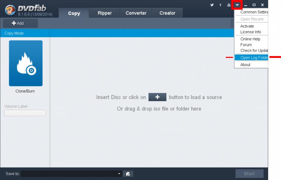

              #21
              (There is no listing for IMAPI CD Burning COM Service listed.)
              This is in case you were using a older browser you need to post the requested log files they contain the information that can help in most cases they can be found here (see screen shot).Post the dvdfab internal and burn log or better yet post them all if your unsure which to post.
