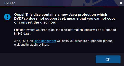

    When DVDFab reads the Midway Bu-ray, the following message appears:
Name:	DVDFab Message.jpg
    How long before the next update?
    Thanks
    I do not get the message using the retail version of the disc, the one that is included with the 4k disc. Please attach the DVDFab internal log session that illustrates trying to open the disc.
      Here you go dvdfab_internal.log
        Thanks, the disc ID for your version is blu-ray F3B53C3C050A17FB3495DCE516BC6E9D6118B0D6, different from mine (blu-ray D668327552D66D71C78830FE448D3BE99332F138), so yours is not supported. Please provide a link to the source of your disc so that it can be obtained and supported.
          https://amazon.co.uk/Midway-Bl.../dp/B07ZVWRT7K
            Thanks, it will take a little time to get support but it will be added ASAP.
              Still the same message with the latest update (11.0.7.9). I have uploaded the requested files to the FTP.
                We will check and get back to you, thanks.
                  The developers have the files from the UK version of the disc and will support it as soon as possible. For faster results always include the DVDFab internal log session and country of origin in the FIRST post

                      I'm having the same error message and problem in Blu Ray Ripper as the original poster, with the same UK/Region B Blu Ray (same F3B53C3C050A17FB3495DCE516BC6E9D6118B0D6 Disc Id).
                      I am running the latest version 11.1.0.1 of DVDFab 64.
                      As this issue was posted 5 months ago does this mean the Java protection on this version of the Midway Blu Ray could not be bypassed ?
                        All,
                        For the UK version of Midway with disc ID ending in...B0D6, please try the copy or conversion in spite of the message. The disc should open. I just made a high bitrate MP4 of this disc that plays perfectly. The developers are still checking on it.
