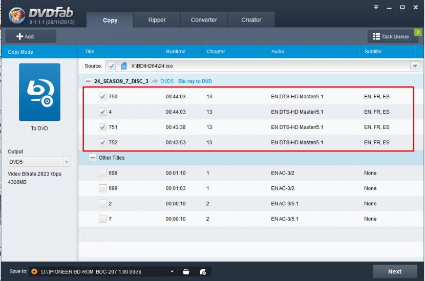

                Kevin,
                What is your source disc?Seasons or TV Serires or the moive only?
                If your source has two episodes(suppose the seasons), dvdfab would recognize it as the following, see the attachment plz.
                If so, drag the titles up or down to change the order in the main movie list.

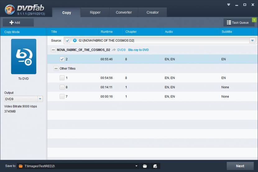

                  Hello Edison,
                  It can best be described as a 4 part mini-series, with two episodes on each of two bluray discs. Unfortunately for the two episodes on the second disc (parts 3 and 4 of the mini-series), ONLY episode 4 shows above the other titles area, even though episode 3 is close (a bit smaller) in size. As a result I cannot drag episode 3 (title 1 on the disc) from the "other titles" area where it appears into the top portion of the menu to make it precede episode 4 (title 2 on the disc). Episode 4 is selected at the top and is the ONLY title shown there, and I can select episode 3 in the other titles section to process both to a DVD with menu, but episode 4 is played BEFORE episode 3 because of the inability to reorder them.

                      Great - appreciate it. I am at my computer and have attached a screen capture of what I see in DVDFab 9.1.1.1 with this problem disc. You can see that title 1 (episode 3) is in the other titles section, and it can be selected in addition to title 2 (episode 4), but it cannot be moved before title 2.
                      Kevin

                          Sorry, I had been away from backing up my movies for a couple months.
                          I just tried version 9.1.2.9 Beta, and the problem is still there. Title 2 (episode 4) on the 2nd disc is selected as the main title, and title 1 (episode 3) is in the "Other Titles" section, and I cannot find a way to put it before title 2.
