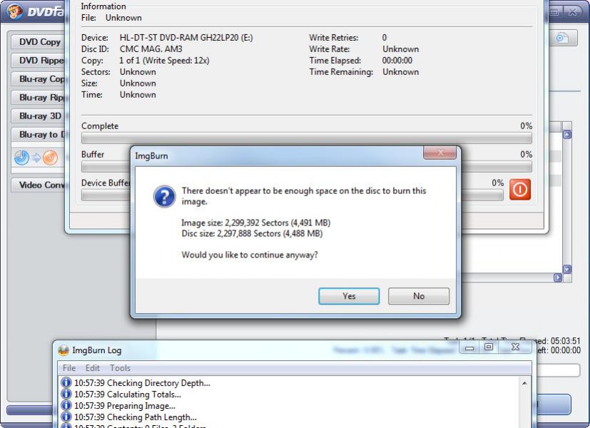

                  DVDFab 8.0.6.6 Still does not compress the Blu-ray enough to fit a DVD5 blank when using custom size instead of default. Internal log below and ImgBurn message attached

                    #24
                    Just did a Blu-ray to DVD conversion using same Blu-ray "Alpha and Omega" and used the Default DVD5 setting of 4300mb. Came out at a size of 4.22gb but I do not want to have to change the custom size of 4472mb to the 4300mb size everytime I convert Blu-ray to DVD as I would have to change it back again.
                    Below is the internal log file of the default 4300mb size that worked
