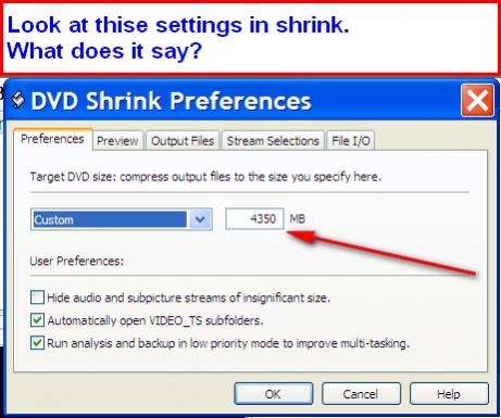

DVD Shrink is doing the compressing of the movie for you, to fit on a SL disc.
