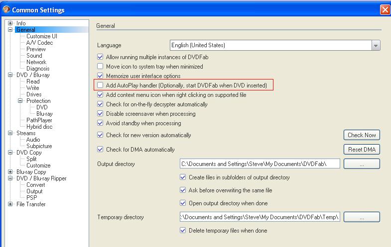

                  Hi
                  I should probably say hehe
                  But i have to stress the fact that both the original and the burned DVD now is starting with loading up the frontpage of DVDFab when i try to play them.
                  So my main question is: Is there any possibility to get the original back? If not this big procedure is not worth starting with.
                  Hans
                    If the autoplay feature is enabled in Windows and in DVDFab this may happen. You need to turn off the Windows autoplay feature in any case and you can turn off DVDFab's feature in common settings, see attached:
                      copying problems
                      Hurrey hurrey hurrey for 90312
                      You fixed it the easy way. Now both the original and the copy plays fine both on my TV and PC. Thank you very, very much. If i had an animation of one bending towards Mekka i would have turned it towards you hehe. Your the chief
                      By the way thank you everybody for excellent service, not at least Signals.
                      High Regards
                      Hans Johnsen
                        You are welcome. The forum is a great resource, as you can see from all those that helped you.
