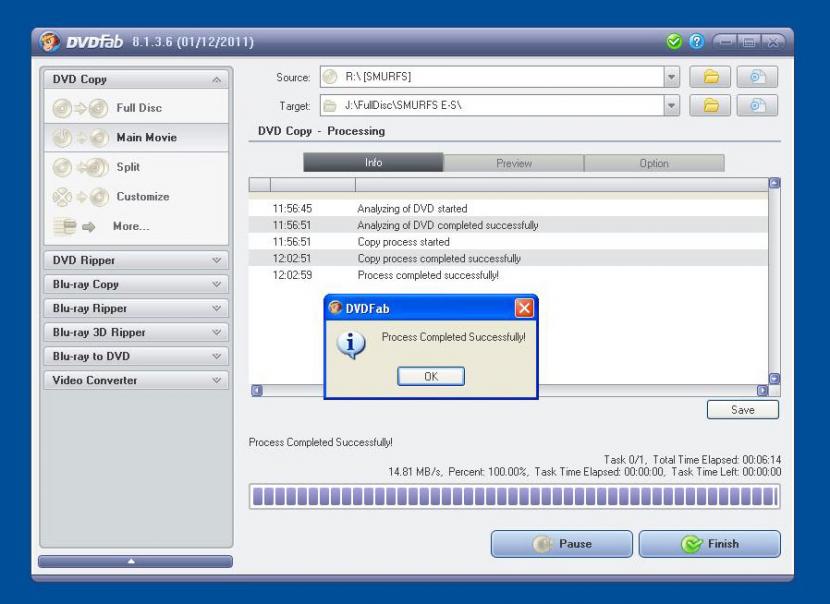

      Smurfs copied in 6 min 9 sec with english and spanish substitles/language

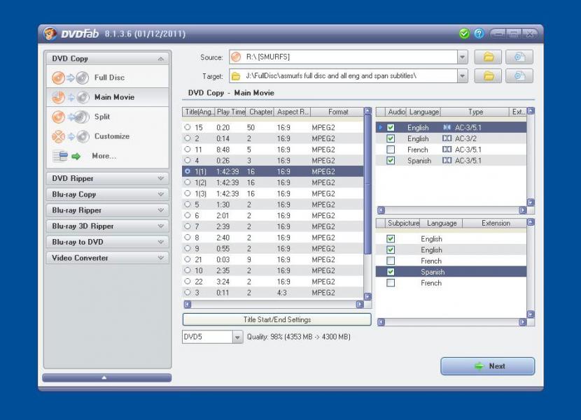

      ANY WAY, AFTER YOU INSERT YOUR SMURFS MOVIE, I TOOK ME 8 SECONDS TO GIVE ME THE READ ERROR, I HIT ABORT, CLICK AFTER THE ERROR WAS GONE: MAIN MOVIE.
      ON THE RIGHT WERE IT SHOWS ALL WHAT IS ON THE DVD I SELECTED THE TITLE 1(1) WHICH IS 1:42:36, THEN ON THE NEXT COLUMN (AUDIO AND SUBTITLES) SELECTED BOTH ENGLISH AND SPANISH(LANGUAGE AND SUBTITLES), HIT NEXT THEN MAKE SURE THAT THE ONLY CHECK MARK IS ON COPY-DVD VIDEO, MAKE SURE TO HAVE A TARGET SELECTED WHERE IT WILL COPY THE VIDEO TS FOLDER(THE MOVIE), THEN HIT START.
      IT TOOK 6 MIN 09 SECONDS TO COPY THE MOVIE TO THE HARD DRIVE, THEN I USED NERO TO RECORD TO DVD WHICH TOOK ANOTHER 5 MINUTES TO BURN A COPY.

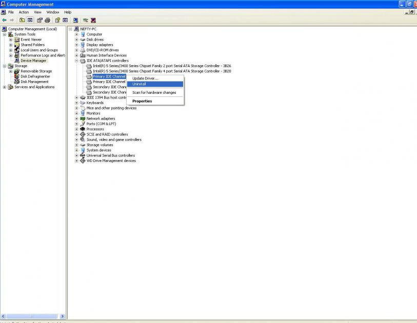

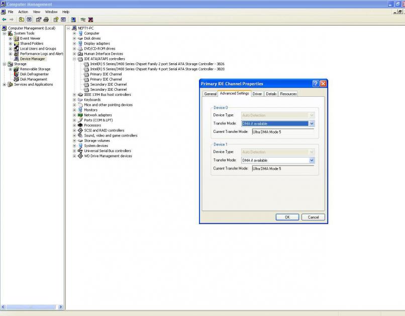

              Here is how to reset the dma manually in case fab does not completely do the reset.
              Go to control panel, administrative tolls, computer management, device management, ide ata/atapi controllers, look at the primary and secondary, right click and go to properties then to advance settings and all should have dma transfer mode, depending on the system the dma mode number can be different but it should not say pio any where in there, if it does then change to dma or dma if available. After you do so and restart the computer, go back and look a the settings if still some of them go back to pio, then you need to go and uninstall the primary or secondary channel hat has the wrong setting, restart the computer again and the system will go thru the process of: Found new hardware and install it again, i may ask you to restart the computer again, after that go back and verify the changes again.
              The dma transfer mode usually go back to pio when you have a bad dvd disc inserted or the dvd has a skip error or read error so it is good to keep an eye on it, you will notice the change when your burning time takes a long time.
              I also had a hard drive that was defective, it will save the info but took a long time to save anything to it, this also affects the burning time or copy times, as well as the size and available disc space, i use 1 tb hard drives 7200 rps, they work very good. Do not copy to the c drive it will take longer as well and slow your system down when copying with fab while doing other stuff in the computer, use a secondary hard drive to do all the copying or burning from. I am including the images of the reset dma manually as well as proof on the time it took the smurfs to copy to hard drive on my computer.
              Hope all this helps, but again you are doing it on your own discretion, i am not responsible for any changes in your system.:d
