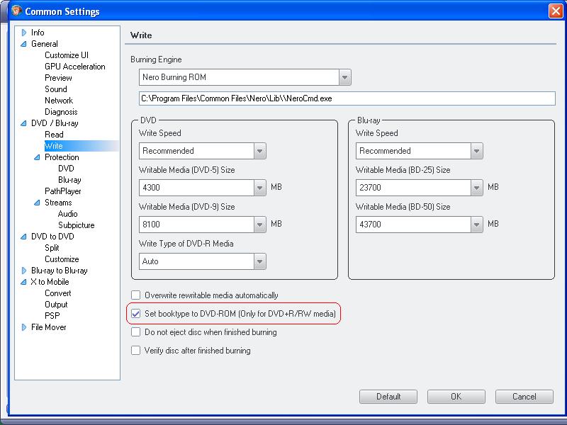

                ok, do you have this box checked in common settings?

                  No, I do not have that box checked, should I?
                    Many players require it.

                      Ok thanks, I'll try it. I read up on it on the website and I have a general understanding of what it is now but the thing I can't understand is, while I have not had it checked, why would one brand work okay and not the other?
                        Some DVD players do not play DVD+R media but all DVD players play DVD-R media which is why it best to booktype DVD+R media to DVD-ROM so the DVD player will think it a real DVD
                          This I understand BUT I have never had that box checked before and I have backed up in excess of 100 of my DVDs ALL on DVD+R media and up until now they have all played on all three of my DVD players without any problems, so obviously my players do play DVD+R. Even the ones I did on my new laptop played fine on them all until I switched DVD brands. This is where my problem began. Thanks again.

                              Yes, I set up both brands of discs as instructed in the tutorial. And since my last post I have created two more coasters. However, I have at least concluded that my problem likely has nothing to do with the IMG Burn settings because I used the burner that came with my laptop for the first one with the same result. In both attempts however I did check off the Set Booktype To DVD-ROM box and it did not make any difference. I guess for some unexplained reason my laptop just doesn't like Verbatim discs. Thanks again for everyone's help.
